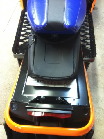

I bought a new bigger trunk bag at the snow do i drill out the four rivets that are holding the old bag in.i am assuming that I do was wondering,the rivets are holding the electrical conduit under the tunnel is there somthing that I have to do to.
Looking for some info I got the instructions but it's kinda lacking on old bag removal
It's a 2015 xtx se
It's a 2015 xtx se

I drilled out those rivets, Put in new rivets for Cat bag. If not going in same holes just put a new rivet back in electrical conduit before you put the bag on. Pic is my Viper with Cat bag on.
X2 I just use that little bag for holding my rope and shock pump. Throw it in the bigger bag like Stingray has.

I left the little bag right under the new one,I have the same bag as stingray.

Yep fits just fine

Yup that's what I did just re riveted the old holes.
I got the bigger expandable bag it looks really nice with the mountin seat
I drilled out the four rivets holding the spare belt bag and filled the holes with the OEM rivets as if no bag was ever there. Then installed the nicer tunnel pack using supplied parts. As mentioned, I just tossed the smaller bag inside the larger one for whatever.

All done and put back together.
