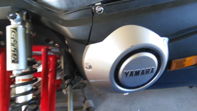

Just put the DZUS 1/4 turn During fasteners on side cover of RX1.
came out with nice tight fit. Can't wait to not fight with them damn screws anymore. Used 17mm and were great fit a couple needed 2 washers was all.

Thanks super, real nice just grab during and 1/4 turn out and your done.
HATE THEM SCREWS
Bought off eBay 17mm pins
HATE THEM SCREWS

Tom each side is about 1/2 hour.
But I used the rivet style backs.
They also have slide on clips, but I had a couple tear outs in plastic.
If your plastic is good-just remove old screw clip and replace with Dzus clip.
