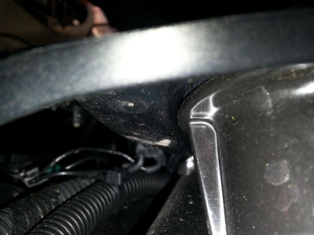

Here's some pics of the stock heated seat wiring from my 2015 R-TX-DX. It looks like the seat connection comes right off the main bundle of wires under the seat. The first picture Im pointing to the harness connector. IN the second you can see 3 wires coming off the switch (see shot from underneath panel) and they hook up to the harness in that area. Third is the switch from the top. Fourth is the seat connected to the harness. Hope the pics help. Stock seat heater may be different than add on wiring for the optional seat heater. BTW, I love the seat heater when it gets bitter cold. I have only had it on for maybe 20 minutes at a time a few times and it will really warms you up. Low is more than adequate for me in near zero temps.

That makes more sense!
