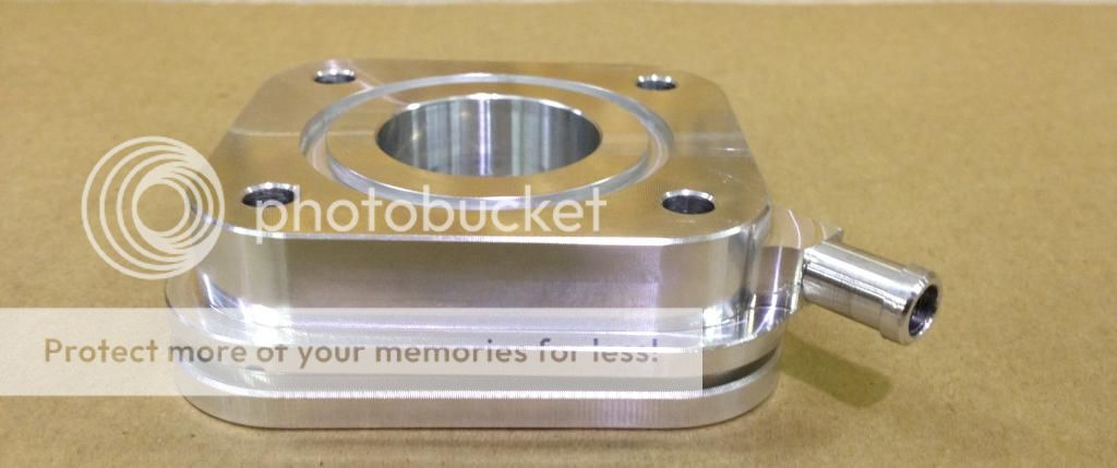

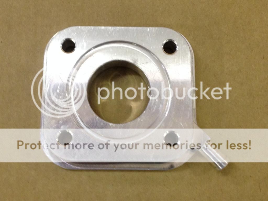

I saw a pic that had the return line go back into where the stock fuel pump is located? Has anyone else seen this kit?
mpi xtx
That is exactly what I currently have. I found out when installing my new TrailTank that it will not fit. The area where that bolts down is too deep.

mpi xtx said:That is exactly what I currently have. I found out when installing my new TrailTank that it will not fit. The area where that bolts down is too deep.

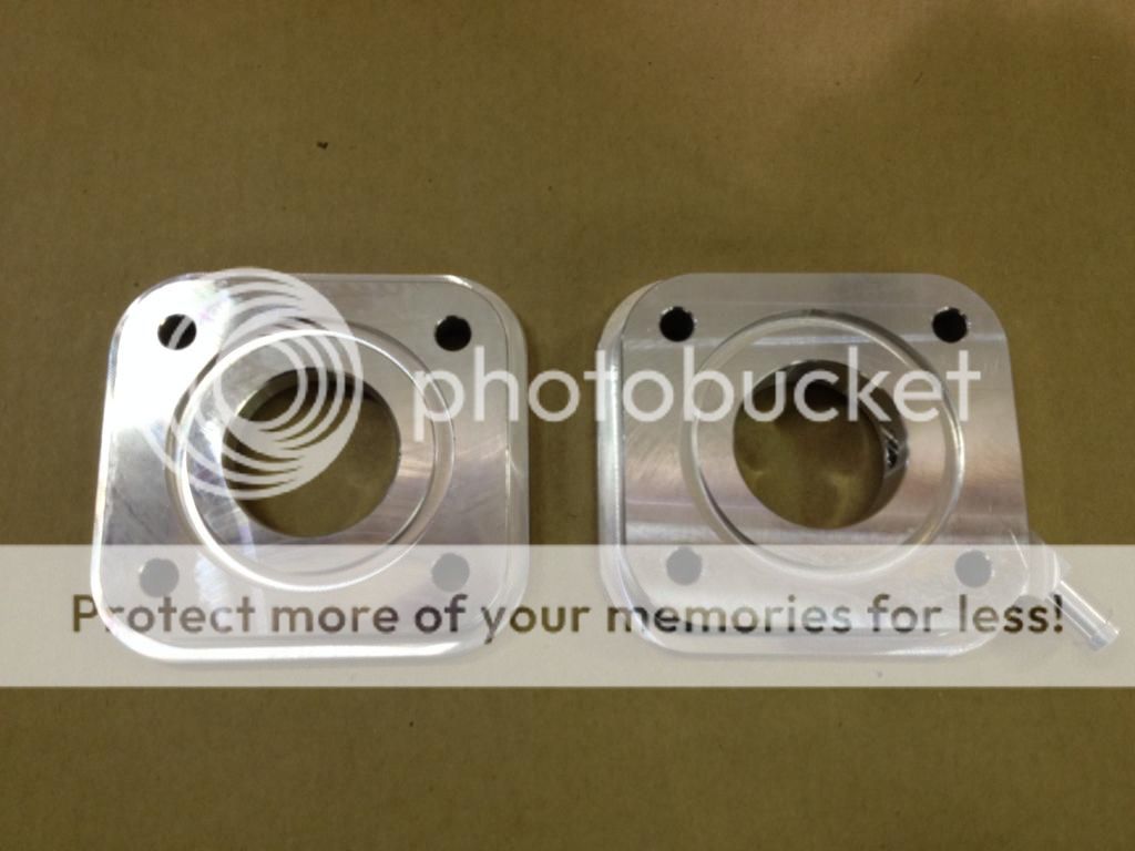

We also have a spacer that looks just like that but doesn't have the inlet barb. Do you have a picture of what your fitment problem is?
mpi xtx
The nipple on the return block hits the tank and because of this the block will not lay flat against the tank. The new tank has too deep of an indent for the fuel level indictor.

Ok what about using this spacer under what you have? Stack the two together?
mpi xtx
I will take a measurement to make it will work. How thick is it?
