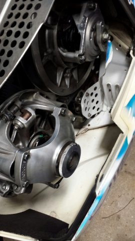

Primary clutch rpm is the concern. They say you shouldn't rev more than 9,500 with primary clutch with stock cover. The reason the Apex and RX1 can rev more is because of the gear reduction.
I have this 911 cover on my sled now so I am safe to 12,000 rpms. Not only that but the 911 cover allows the clutch to move more free, has a larger bushing, strengthens the towers and you are able to adjust the primary so the clutch doesn't slam against the belt.
