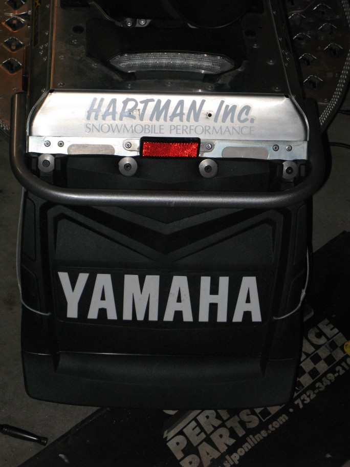

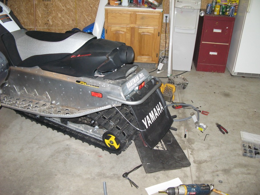

Lowered it approx 1" and added cables to keep it from standing straight out after ice packs behind it.
The guys said its like riding behind a
Also used round 1/2" closed cell foam in between the chassis and the flap to prevent the dust from covering tail light and then lowered the reflector so I had a good place to put a cool Tom Hartman Inc. sticker on too.....

The stock flap also gets hung up in the trailer cover

Looks good, have you tried it? I'm sure it works, I'm just wondering how well. Great idea and nice, simple execution we can all do.

Be careful when using reverse. With the snow flap lowered it will be easier to catch it in the track when backing up.

Great , until you back up !

Guys its only lowered 1" with stiff cables that also make it harder to bow backwards. I realize the downsides of a low snowflap but its just another issue for this sled IMO. When your snow dust and CHUNKS has your buddies black and blue and actally pissed off.

unchained, 1" lower when in reverse will push the snow flap into the track, even with your cables added to it. Don't take everything as criticism, simply take it as a useful suggestion on what to watch out for when using reverse.
