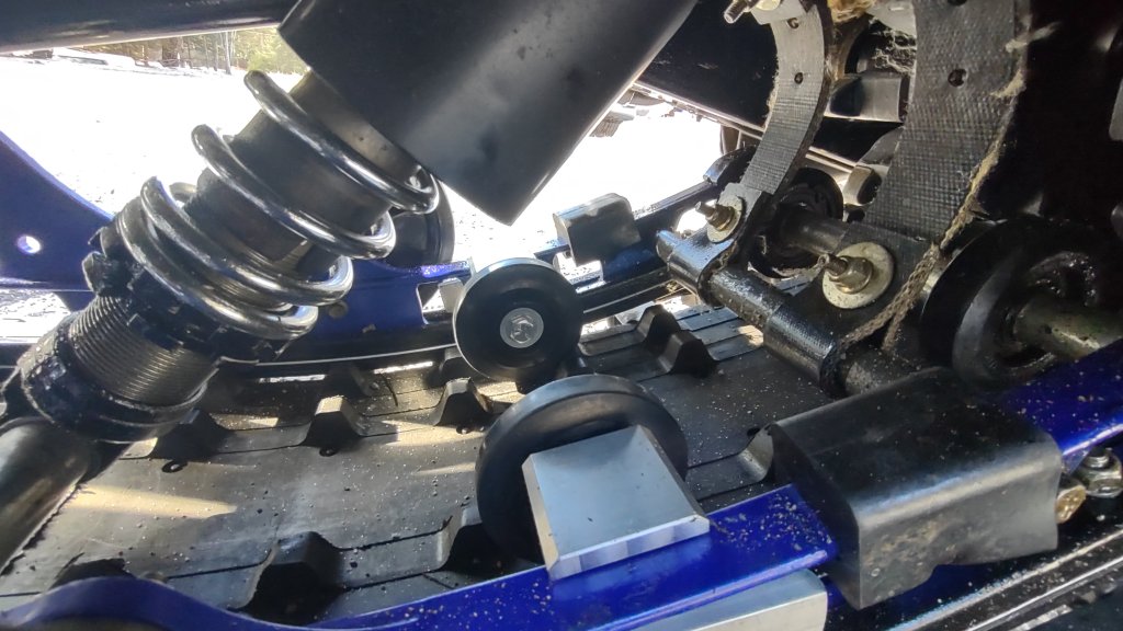

I've been testing the marginal snow wheel kit and larger idler wheels from Travis at Barn of Parts and so far they are holding up well and appear to be helping. No noticable wear, and I've been riding in low snow conditions all season.I had been looking also for some marginal snow wheels like I ran on my Apex.....

Where do they get installed?I've been testing the marginal snow wheel kit and larger idler wheels from Travis at Barn of Parts and so far they are holding up well and appear to be helping. No noticable wear, and I've been riding in low snow conditions all season.
Wherever you have the most wear. For me it's at the bend, up front. I put them inside the skid because there isn't a lot of clearance to the factory idler wheel that's on the outside of the rail.

Okay nice.Where do they get installed?
Wherever you have the most wear. For me it's at the bend, up front. I put them inside the skid because there isn't a lot of clearance to the factory idler wheel that's on the outside of the rail.View attachment 175238

Notice any additional noise/vibration/drag? Those little wheels are turning hellish RPM at even fairly modest speeds. If you do the math, at 80 MPH those little wheels are being asked to turn over 7000 RPM! While I'm sure they sure prevent wear at the classic spot for ProCross rails, how much do they cost in terms or performance/speed?Where do they get installed?
