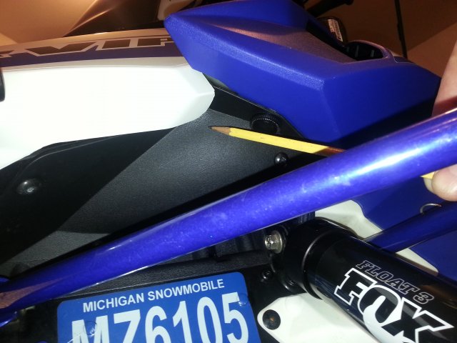

Double check this area where I am pointing with the pencil. If the colored part of your hood is on top of the black plastic it causes the back to pop out because the hood doesn't slide back all the way. If the hood is on correctly the colored plastic on your hood should be below the black plastic like in the picture.
