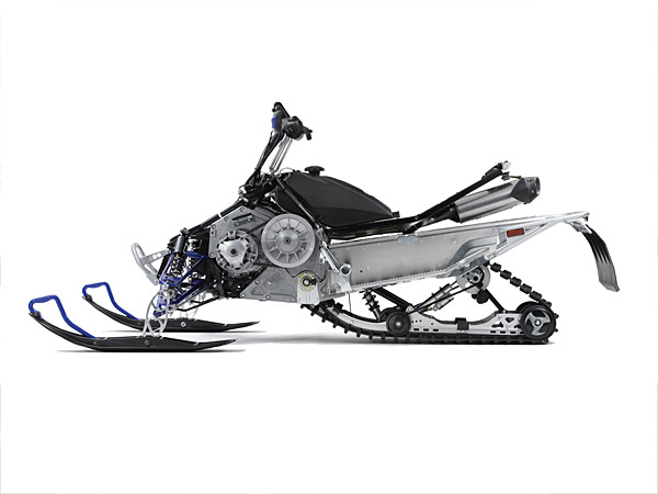

Okay, look at the large pully on the right. Shove in on the inner half while rotating and it opens up the space between the two halves. This allows you to pull the belt up and over the outside by making more space in the center so the lower half of the belt will reach the center shaft. Easy peasy.
