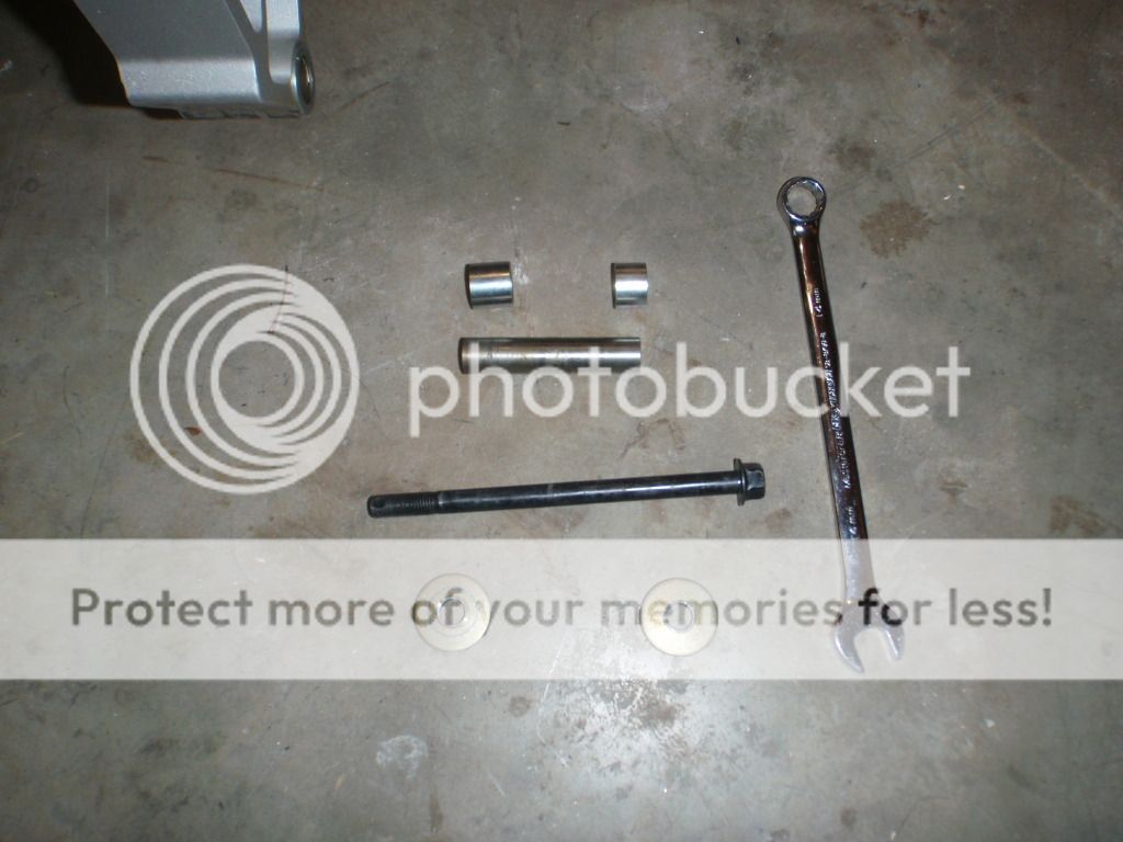

Here's a pick of the bolts/collars/washers:
Basically, the parts in the picture and the rubber stopper are the only parts that are not common between MTX and XTX that are needed for the Gripper installation.

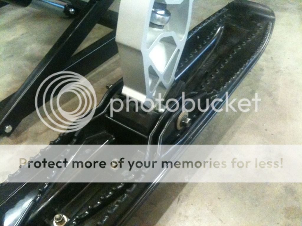

The 5/8x5/8x3-1/2 rubber pieces fit in the outside spaces, and the 1"x5/8 fits in the middle space which you can see in the following pic. Also note the bushing are installed in this picture

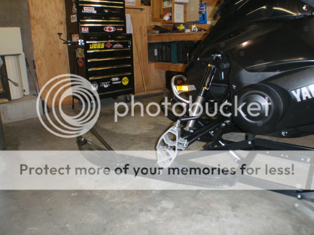

Finished and installed.

Finally, I put the ski on. It was as good a fit as my XTX or MTX ski, IMHO.
