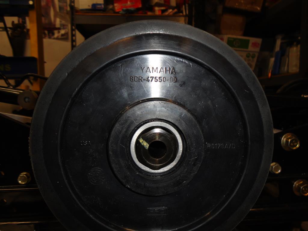

These may be the way to go. The rubber should help prevent flatspotting from Ice. I recommend buying new 6006 bearings (stock Phazer) for them though since ones in there are CHINA and I have seen failures of bearing. Part # and cost TBD but they are off a 2014 AC SnoPro 600. Let us know how they work out long term if you choose to try these.

Would you have the exact model number of the sled? Like ZR 6000 RR? Parts catalogs list by these model numbers. The ZR 6000 RR seems to be the closest relative of the racing version but the pictures I'm getting of the wheel are different (no radial ribs like the one in your pic) and the part # is usually stamped on the wheel. Maybe the online fiches haven't caught up yet.

This should be the one I'm going to see what my local stealer wants for one Monday.
Wheel, Idler
3604-616

Ordered a set today from my local dealer,hope they work out.
Yes 3604-616 is the wheel # from a 2014 SnoPro 600.

Just picked up the wheels today, they look good , these are going to be great. Tonka wheels would be a great upgrade compaired to the stock Yamaha wheels though :)
