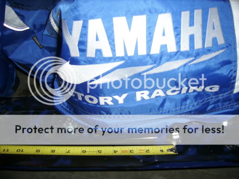

08NitroRTX
Picture is worth 1000 words!
These should help you to be able to understand what I mean by 10" in front of and behind ski mounting bolt.

unchained
perfect, thanks!08NitroRTX said:Picture is worth 1000 words!
