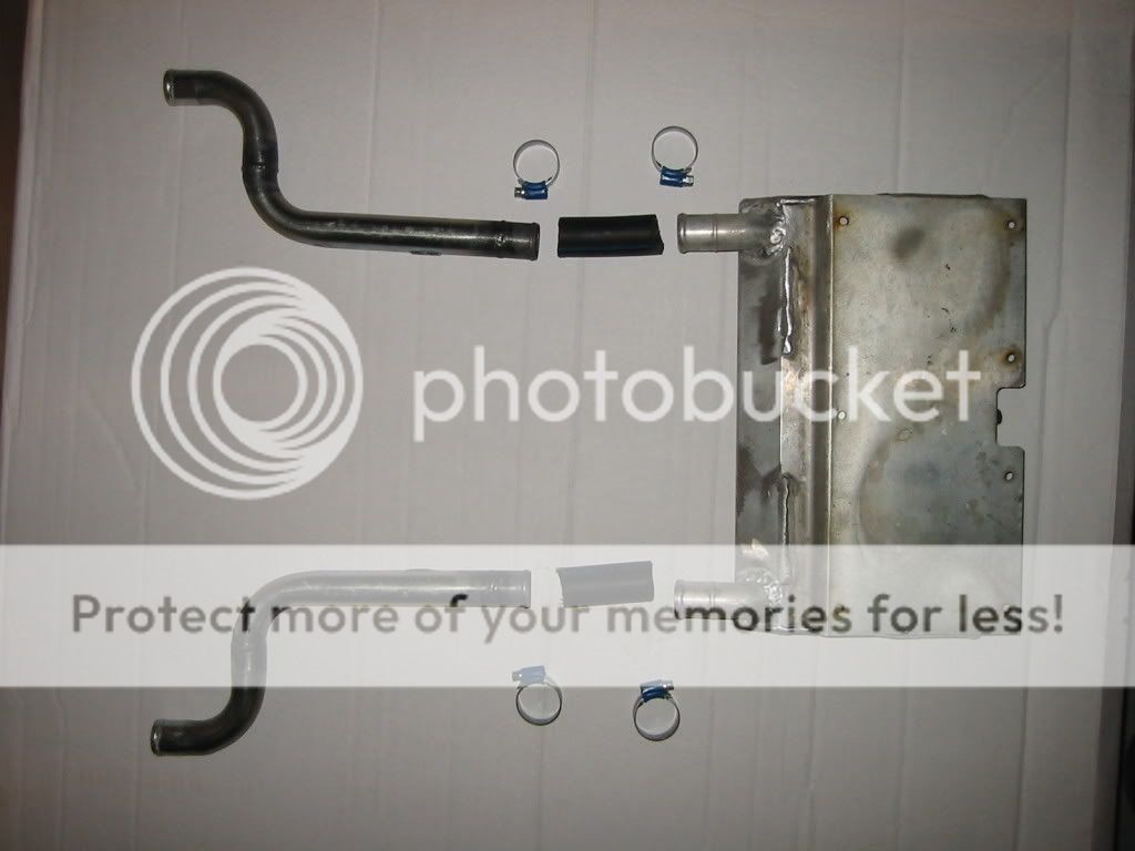

OEM rear heat exchanger was modified to fit the new tunnel ext. from MPI. This setup was made by welding 2 OEM crossover tubes and relocating/welded the in- and outlet on the heat exchanger. This setup has worked flawlessly since finished. My friend has copied it on his sled.

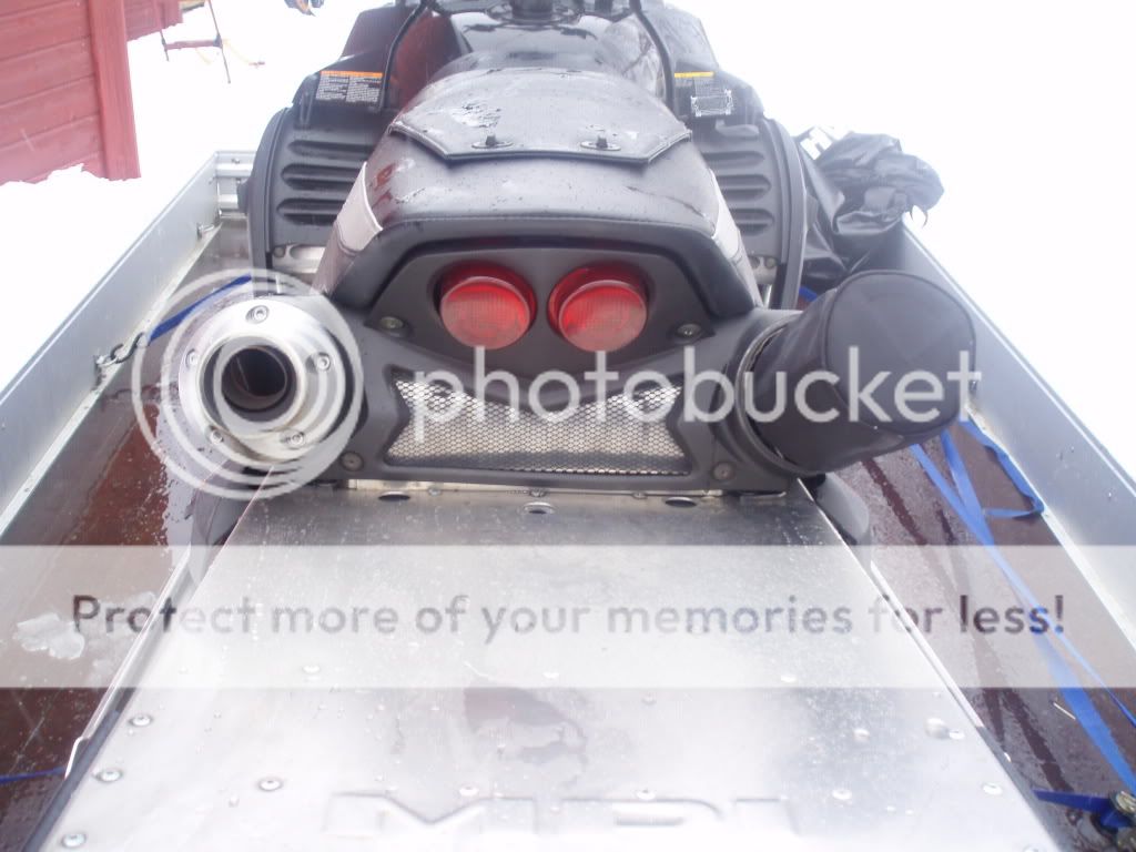

Tunnel ext. was changed out with a 159-162 MPI ext. MPI bumper was swapped out with a Ski-Doo bumper. A lot more functional when you get stuck!

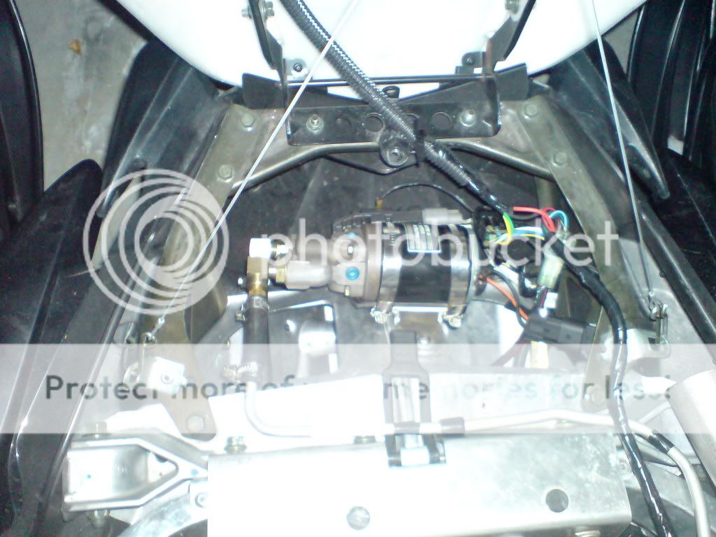

Fuel pump and regulator assembly. Re-lay got plenty of de-eletric grease and fuel hoses that run close to engine and clutched were upgraded with heat insulation tape.

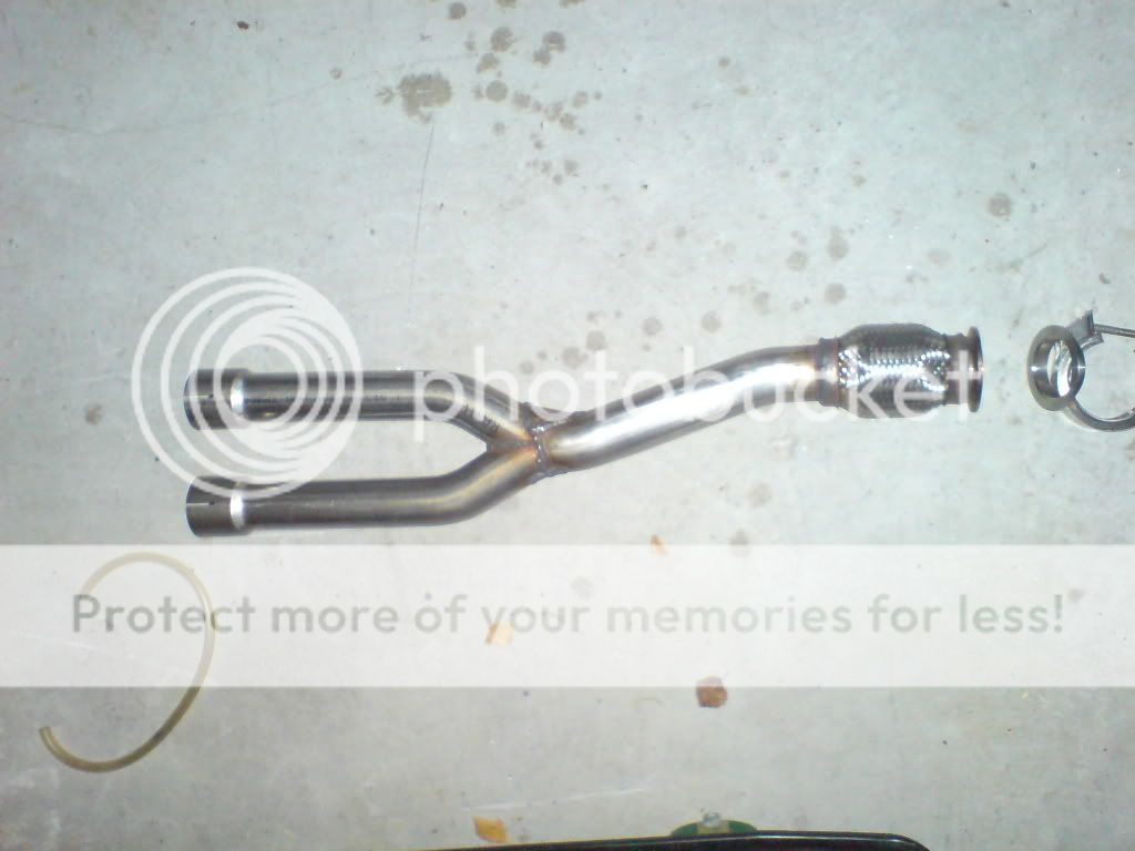

This is Justin Fuller @ Full Power performance new exhaust pipe for the Bender kit - with added flex pipe and V-band. No more leaking exhaust.

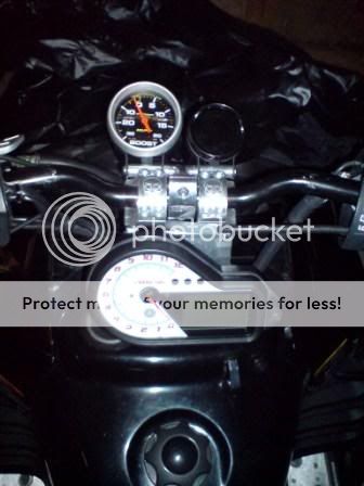

New 8" risers bought from Doo_man was installed. Also bought guage brackets from CR-racing - NICE!!!!!!!

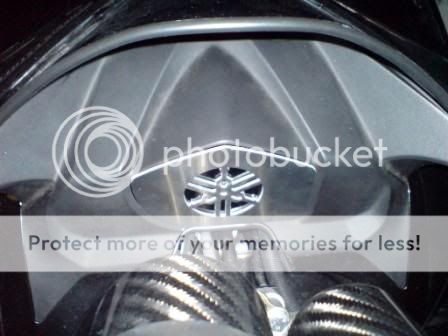

When I moved the Speedometer from its' original place it left ugly holes. I tried different solutions of covering it up, but was never satisfied. So made this bracket/plate with the Yamaha logo to cover the holes. Made on Autocad and cut on a flowjet/waterjet

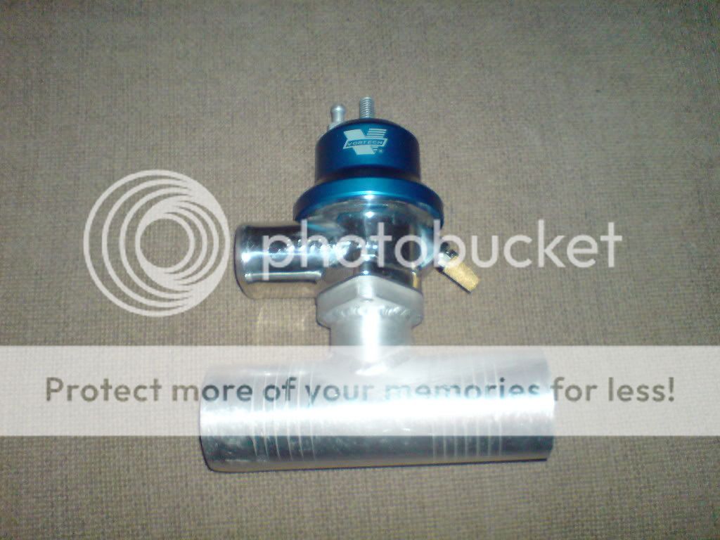

The Vortech bypass valve needed a new adapter since MCX piping is 2" and not 1.75" as the Bender kit has. I had a alu weld flange in the garage - bought from Ted J: Small pipe from the flat flange was done on the lathe. Rxrider saved my a.. by providing my with the 2" pipe. Piping is not easy to find in my hometown. THANKS again buddy!!!!!!!!!!

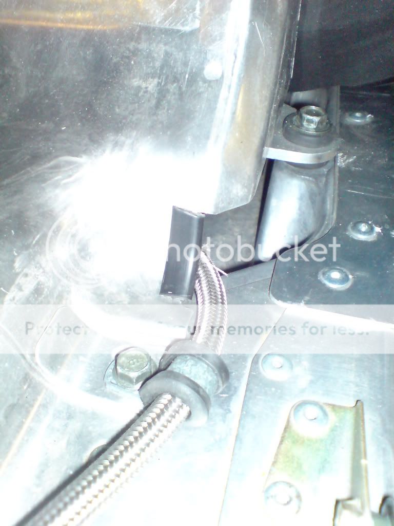

New heat insulation on the oilreturn line and vent line from the oilpan under the turbo. I have installed rubber pices on all places were lines rubb agains frame/parts etc.
Same thing - rubber to make sure of no wear on oil feed line.

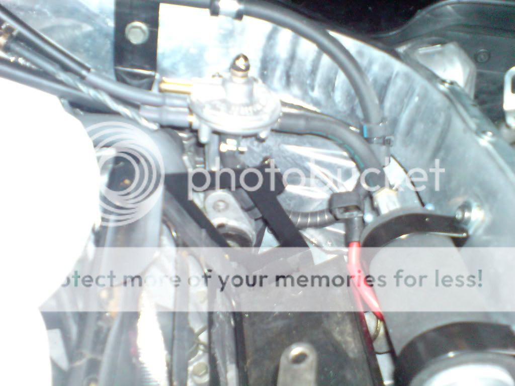

New bracket to the Malpassi 241 fuel regulator had to be made. You can see that I have installed a spring around the gas return line. This is to make sure it doesn't collaps when expossed to heat from engine and clutch. Hose is also held in place with rubber supprt clamps to the D-frame. Extra rubber pices in evry place it rubbs against the frame. The kit got a new walbro fuel pump - bought from MCX.

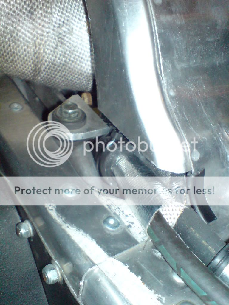

Heat insulation installed on all hoses around the turbo (feed-, return., ventline etc.)

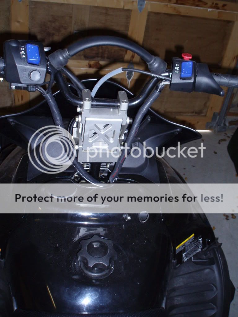

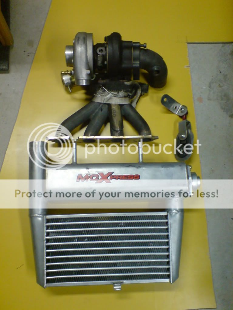

When I decided to buy Rxriders MCX "leftovers" - this setup has been spinning around in my head and caused me many sleepless nights. Thanks Sean aka Bullet - LOL !!!!!!!!!!
Bullet did a mid mount conversion of his Bender kit with a Impulse header and down pipe - toghether with a REV gas tank. I was sold on the idea - boost addict - LOL.
The reason for just not doing it with the Bender kit - is that I plan on using left over parts from the RX-1 MCX kit on a APEX MCX kit. I wanted to sell the Bender kit as a complete kit - and not have a bunch of Bender parts on the shelf. Only one other Bender kit in Norway that I know of. So parts would just collect dust in the garage. Kit is stil for sale!
I am still collecting parts. I am still looking for a Apex MCX intercooler, fuel box and injectors.

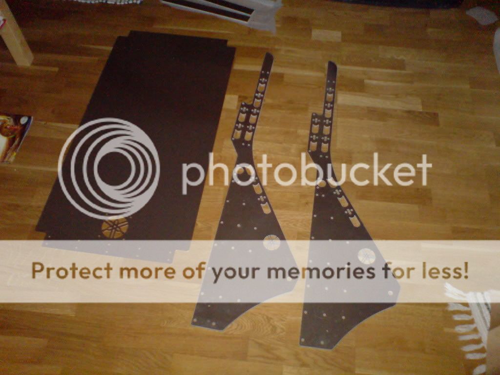

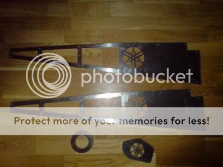

During this winter I have been building my own VE-style tunnel. All parts are drawn in Autocad by myself and been cut out on a flowjet/waterjet. The plan was to install the tunnel during Christmas, but tunnel is not finished yet – still have to make the kick up runningboards. So install of the tunnel has to wait until summer.

LOVE the tunnel and dash trim pieces. Nice work!
RedRocket
What a great project! The tunnel pieces are incredible.
