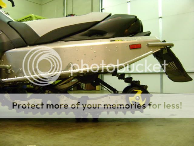

First things first, here is the before picture. Keep in mind that I'm not a professional photographer and if anyone needs clarification or a more detailed picture, please let me know.
Looking at the lack of track reminds me of my 2002 piped Viper and the Yokohama track trying to put the power to the ground. Didn't work real well.
The answer for that came in the form of a 136" Ripsaw and that is what we will be putting under the Nytro.

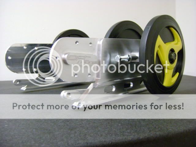

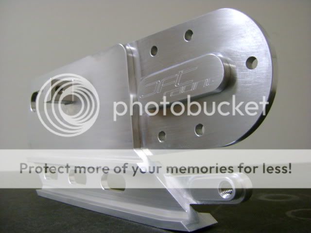

Alright, we need some rail extensions. I wasn't happy with what else was out there and I have a few other ideas on what I wanted to see incorporated into the design. So, here is what I came up with:
I really like what Yamaha did with the 6 degree tip up rails on the XTX and think that this will work the best on this sled. It should keep the back of the sled nimble on the hard pack and add the desired rough trail/off trail effects of the longer track.
These rail extensions are machined for an 8" wheel and can be configured in a 2, 3 or 4 wheel set up. They use the same external track adjustment that our 153-162 Nytro MTX rail extensions use. If there are people out there interested in using the kit with the stock 7" wheels, this can be easily accommodated. The goal was to make an extension that had seamless mounting and matched the lines of the stock rails while incorporating the 6 degree tip up. The owner of the sled chose to go with a two wheel set up. Here are a couple pictures of the skid prior to installation:
The answer for that came in the form of a 136" Ripsaw and that is what we will be putting under the Nytro.Alright, we need some rail extensions. I wasn't happy with what else was out there and I have a few other ideas on what I wanted to see incorporated into the design. So, here is what I came up with:

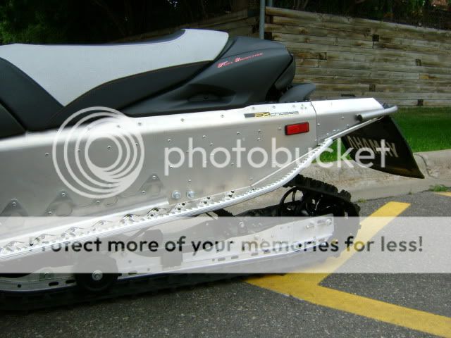

Finally got everything back together. Here are a couple of pictures of the sled as a 136"
I sure love the look of the Nytro with a tunnel extension on it. Just seems to look more balanced to me. And, you can't beat the extra traction and floatation from the longer track. Can't wait for some white gold to try this one out and fine tune the clutching. Gonna be a fun one.

Thanks for the feedback and compliments everyone.

Those extensions are AWESOME, they look factory. I bet that was a lot of work getting that sucker into CAD the first time.

Here is a nice side by side:
