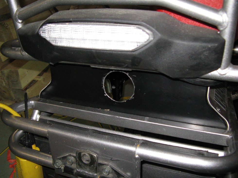

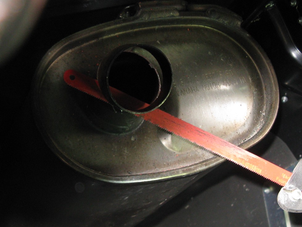

This is my first try at doing a mod to try and rectify the tunnel icing build-up on the VL. I have extended the exhaust outlet from the muffler to exit through the rear.
- Four different parts were used to do the job.
(1) Flexible tail pipe repair pipe was used so that I could easily centre the pipe because the outlet from the muffler is off centre and to bend pipe to fit would be difficult. Hopefully this flexible metal pipe will withstand this application (if not, it's back to the drawing board).
(2) Stainless steel adapter used to attach the flexible pipe to the SS tip. The tip has three set screws for that purpose.
(3) SS automotive tip was added at the end to make for a custom look.
(4) Template was made of the profile of the rear and a SS plate was cut to that shape and the tip was welded to it (done by local welding shop). I realize this SS plate was not really necessary and adds weight but I liked the look better than the original black. (Another option here would be to weld a ring to the tip large enough for holes to attach the tip).
At this point I am unsure about adding a plate to block off the muffler/exhaust and/or to wrap the exhaust - I may test this mod first. I think even this much has to be an improvement, i.e. less heat in the tunnel = less ice. At a minimum I may have to add a plate to protect the flexible pipe. Here are the pics with explanations; any thoughts and suggestions are welcome:

Sweet looking outlet Bomba, I like the stainless touch. I will be looking forward to hearing how the mod works out. As you know I left the plastic in place and just releaved it for the pipe.
BombaPolaYama
karl said:Sweet looking outlet Bomba, I like the stainless touch. I will be looking forward to hearing how the mod works out. As you know I left the plastic in place and just releaved it for the pipe.
Thanks - yeah it looks cool with the exhaust shootin fumes out there I must say. All I need now is somw snow ans cold weather to test it - so far the season has been a write off in my area.

Nice work Bomba. Glad to see you got in there and wrestled with it. I can't imagine cutting that muffler end with a hacksaw blade. Took some doing. Reminds me of the saying: If you think you can or you think you can't, either way, you're right.

Bugbear said:Nice work Bomba. Glad to see you got in there and wrestled with it. I can't imagine cutting that muffler end with a hacksaw blade. Took some doing. Reminds me of the saying: If you think you can or you think you can't, either way, you're right.![]()
Thanks - that's a good saying (never heard it before) - it's all in the head eh. Actually there is a small handle on the blade so not quite so bad as it looks (ahah)
