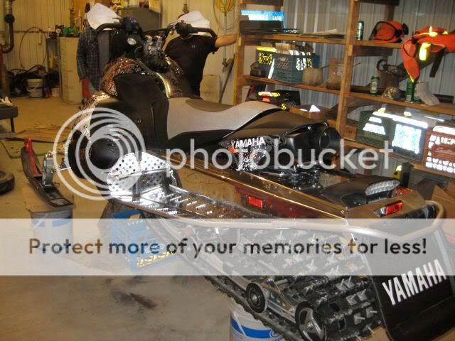

I was really happy with how mine came out.... Took some good advice from Shadow!! AND some elbow grease from friends, lol Thanks KevChev

There isn't many places big enough to get a 3" polishing wheel on a drill, let alone a 8-10" orbital.... Some areas just HAVE to be done by hand.
Looks great and I have been trying to talk myself out of doing this and this is not helping.
