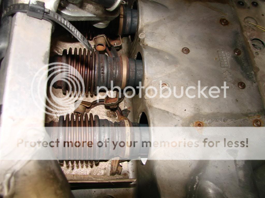

I installed a set on my Nytro Yesterday as the exhaust started making noise on our week trip. All I could find of the OEM donuts was a 1" long piece, the rest was GONE!
So I put the Bronze ones in without any sealers at all, put it all back together and started it. Stuffed a rag into the muffler to test for leaks and it sure seemed like it was going to stall if I didn't pull the rag.
I also have a set in Dad's Vector without any sealer. It has around 1600KM on it with those but it doesn't feel like it's going to stall with the rag test, but the RPM does drop some. After this weekend in Muni, we'll pull his down and have a look see.
Dok C has PM'd me with some info that I'm waiting for permission to post or for him to reply here with.
I'm leaning more towards just selling these with a couple disclaimers on wear/minor leakage, especially if i can keep the cost down to the $15-20 each range.
I've spec'd these out a little 'thicker' than the OEM ones mostly to help trap the pipes without bottoming the clamps, which should save everyone from having to grind the clamp to get them to close further.

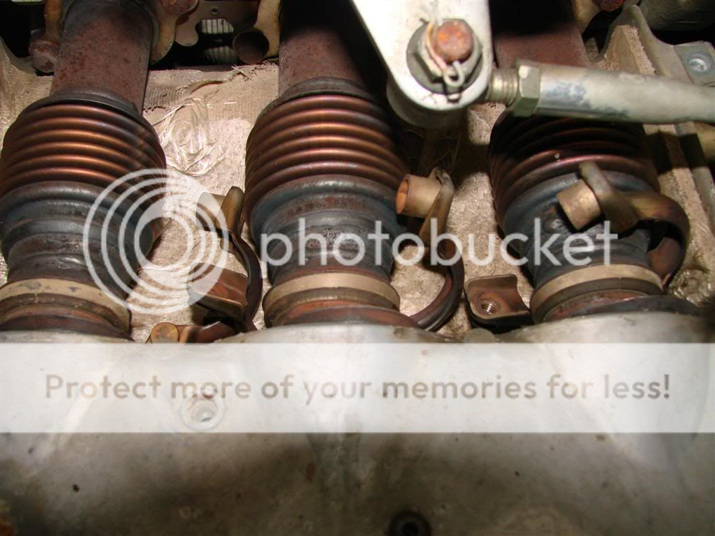

Here's the PM from DokC:
Alright...I've finally got my sled torn down again to check these out.
1200kms (I know...not a lot...but that's where I'm at). They seem to be working great. My clamps aren't turned and there doesn't seem to be any wear on anything.

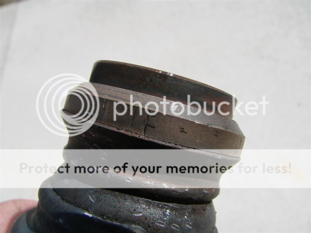

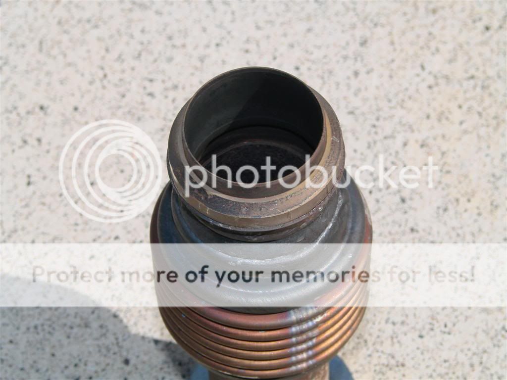

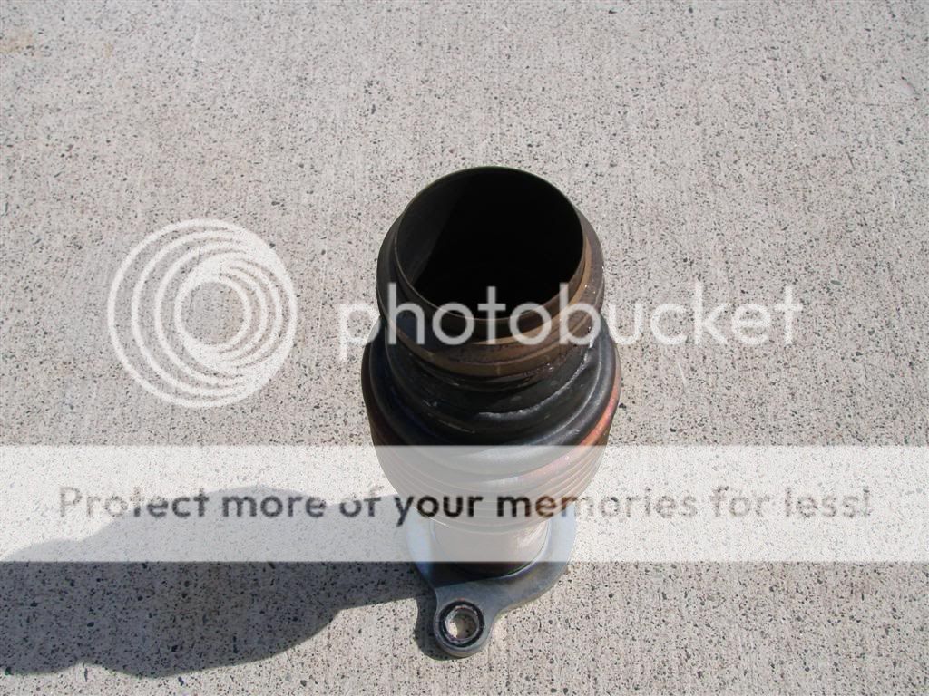

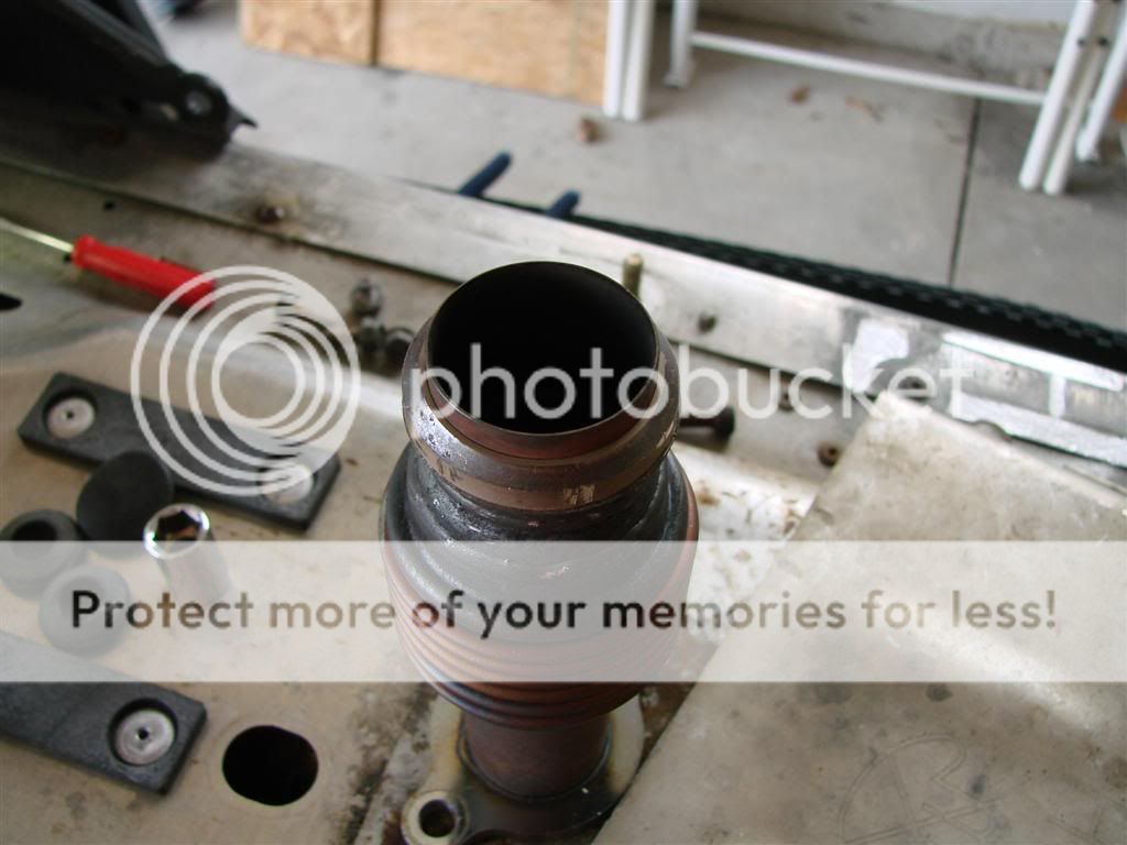

Well, I pulled down the 06 Vector to have a look see. These donuts were installed without any Ultra Copper or other sealer and ran for around 2000 KM or 1200 Miles. When I plug the muffler, the sled idles down some but doesn't stall. I believe its the muffler gasket that is leaking in this case as no matter how tight I got that clamp, the muffler would move around like it was still loose. The other test mule, Nytro, will stall out if I plug its exhaust but it only has 250KM on it's gaskets.
I'm not sure what exactly happened but I could NOT get the donut off the flex pipe....tried channel locks (you can see some witness marks in the pics) and without ruining the gasket I decide to leave well enough alone. Only thing I can figure is that some carbon got under it and filled up any gaps or the donut actually shrunk due to heat cycling. At any rate, I think a cut off wheel and a steady hand would take them off no problem. All three clamps were still tight when I removed them (stock clamps, no grinding off the posts).
Put the flex pipes in the freezer for a couple of hours. Might help pop those donuts off
try soaking in transmission fluid and the freezer. transmission fluid is good for penitration oil.
