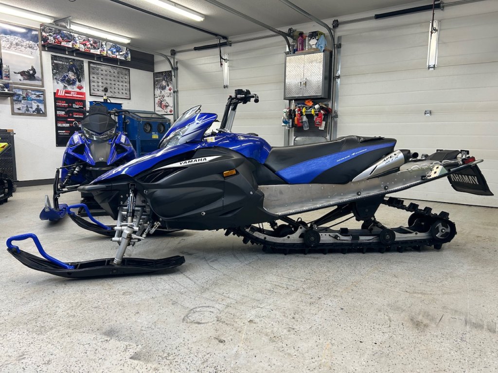

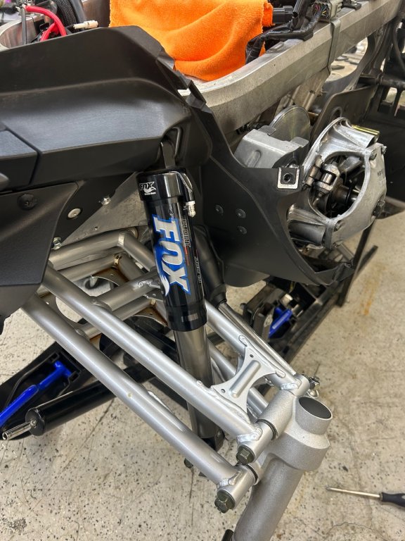

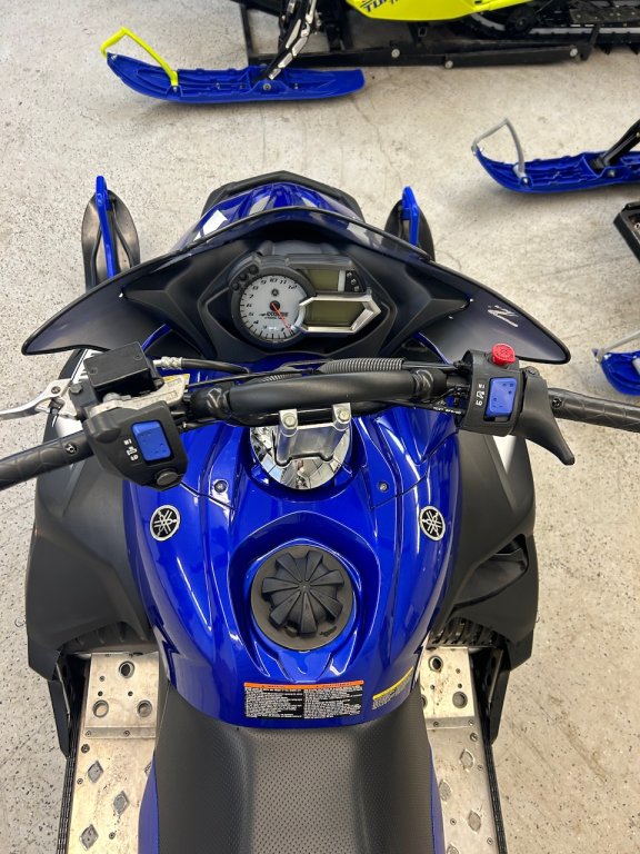

Found a beauty 2008 Apex m-tx. New project for me. Planning on restoring it to new condition under the plastics….as new as I can. I’m excited to ride an apex again.

Nice whats your plans with it?Found a beauty 2008 Apex m-tx. New project for me. Planning on restoring it to new condition under the plastics….as new as I can. I’m excited to ride an apex again.
View attachment 175606View attachment 175607

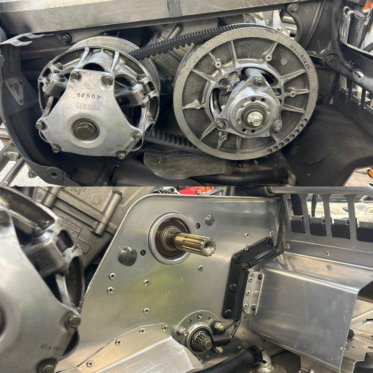

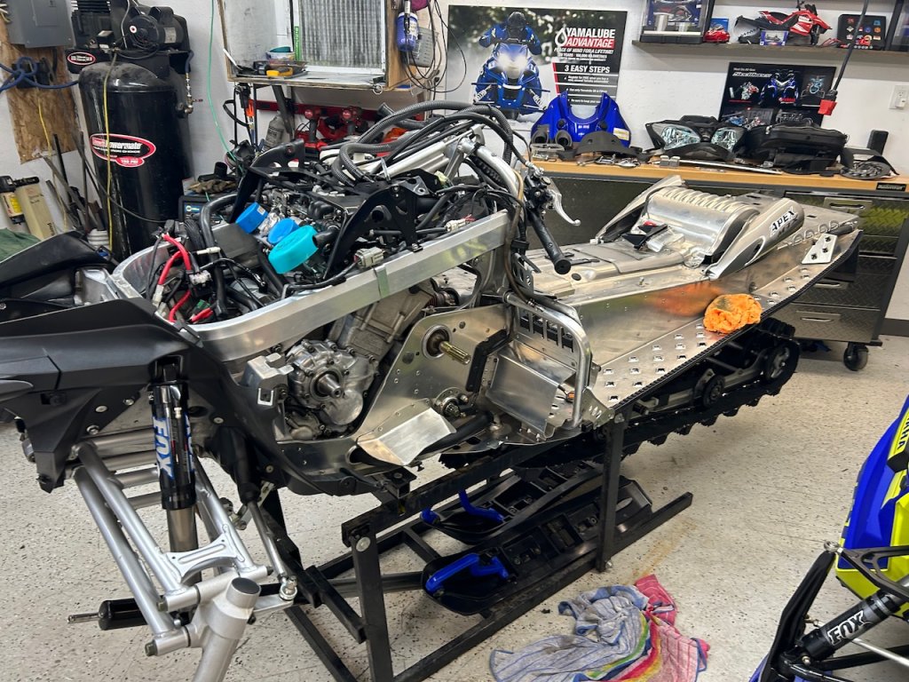

I plan on cleaning it up …update repair anything that needs to be done. I wanted an apex like I used to have for trail days/hard pack conditions. Vapor blast the clutches, steering blocks, front suspension oilite bushings.

Awesome!! Keep it coming!!I plan on cleaning it up …update repair anything that needs to be done. I wanted an apex like I used to have for trail days/hard pack conditions. Vapor blast the clutches, steering blocks, front suspension oilite bushings.
View attachment 175645View attachment 175646

Planning to powder coat the chaincase and battery holder. Strip and powder coat the front an arms and any rear suspension pieces. Honestly it’s very good shape for a 16 year old sled. I’m excited.

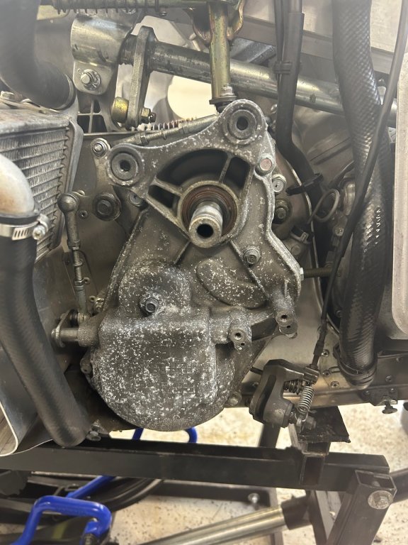

Coming along. Magnesium sure likes to corrode. I’ll glass bead the chain case and see how it looks. If it’s not great I’ll probably powder coat it silver.

That’s going to look sick!!Coming along. Magnesium sure likes to corrode. I’ll glass bead the chain case fand see how it looks. If it’s not great I’ll probably powder coat it silver.

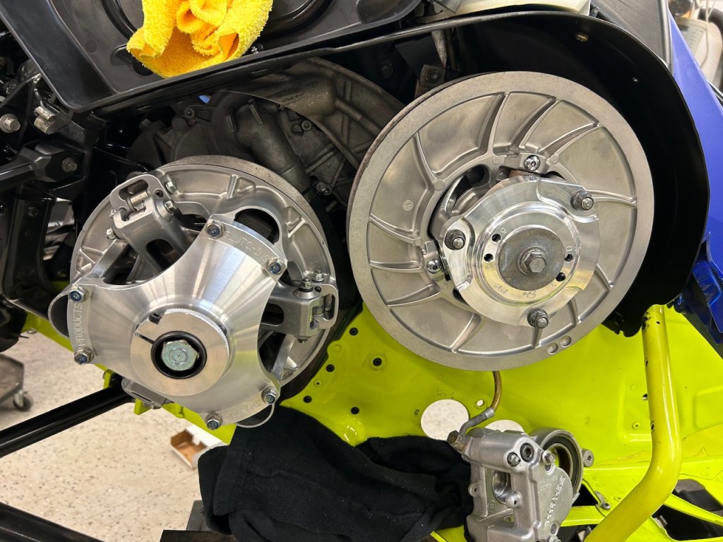

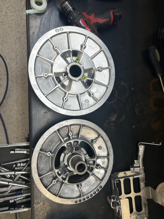

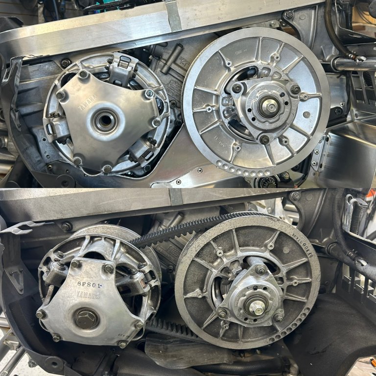

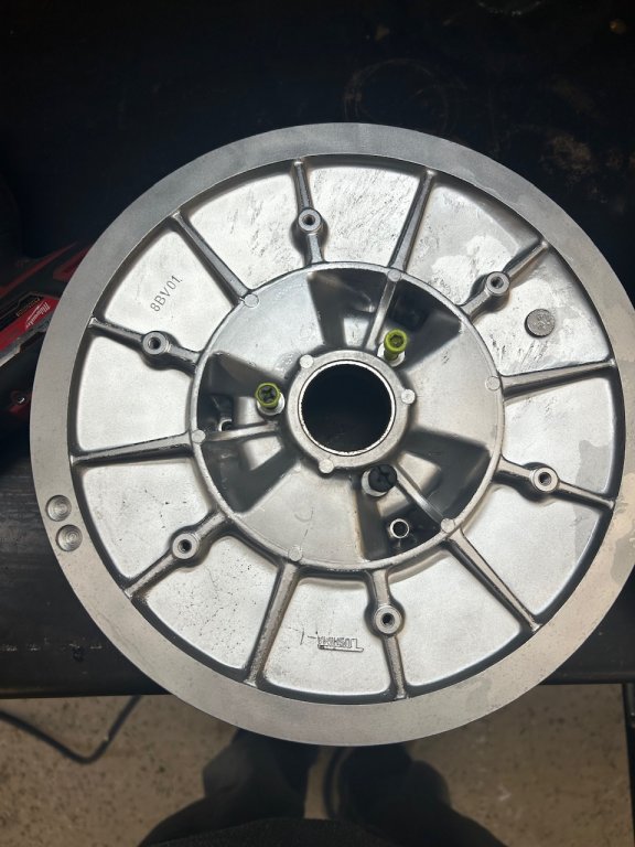

Almost finished Vapor blasting one side of the clutch. Cleans up nice.

Right!! It will definitely be a show piece!Almost finished Vapor blasting one side of the clutch. Cleans up nice.
View attachment 175676View attachment 175677

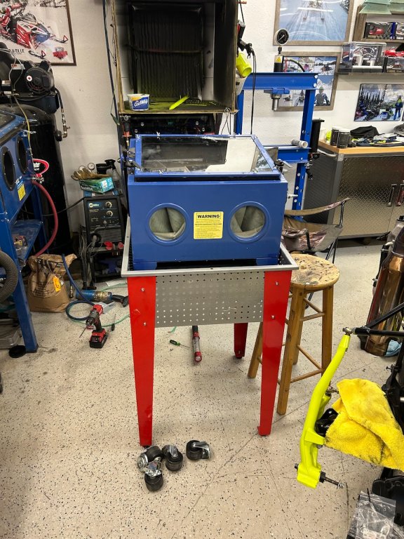

I just made my own Vapor blaster out of a used bench top sand blaster. Pretty cheap to do. Fine glass bead and water. Water sand drains to a pail below with sump pump that pumps the slurry
I putty up the slider buttons on the primary so nothing gets between the buttons. But it sure cleans them up nice. My sidewinder came out really good.
