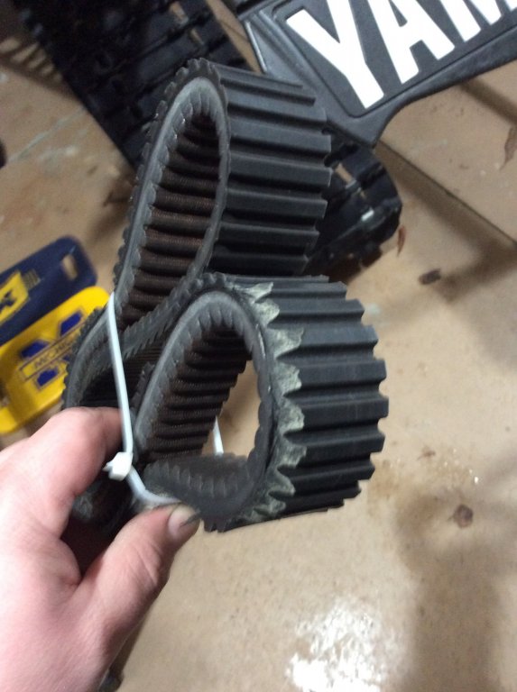

Is this normal to see on a carbon fiber belt with only 900 miles? Overall I love the belt performance.

I ran the C12 for the past two years and am not going to buy anymore. The reason, six belts and only one blew. 4 delaminated like yours, and one is still usable. I have tried the Kevlar version, but don't have many miles on it I will need to adjust weights a bit to get RPMs where they need to be. It does seam to be similar compound and runs much lower RPM than the 8JP. Overall, not happy with the C12 delamination in less than 1000 miles.View attachment 145436 im running a gates carbon fiber equivalent to the 8JP. It was new this season and I broke it in properly. Noticed some of the ribs have peeled off with 900 miles on the belt.

My gate's c12's don't delaminate, they disintegrate around the 600+ mile mark, but we all know how I ride.

Seems pretty early for delamination but sounds like that's a know issue with carbon fiber belts. I liked the performance and consistency with RPM's on this belt but at $95/belt I need more mileage out of them.

1,500 on my 8jp length Carbon and it still looks/performs like new. Only have the original 8jp as backup, might be time to grab another carbon. How was the belt stored? Gates specifically notes that you shouldn't put a backwards bend in the belt but that's how the stock belt bags hold them.

That look suspiciously like a ride away with the parking break engaged.

I only took one picture but there are several sections along the belt like this in some fashion or another. PLUS, my parking brake lever has been broken all season so I don't have a parking brake at the moment. (red clip to set brake snapped off last year)
And I don't do brake torques etc... Just a trail rider for speed!!

Good news, Gates is going to warranty it. Just hope next one does better.

Did you need a receipt?Good news, Gates is going to warranty it. Just hope next one does better.
I know gate's had a bad batch of cf belts a season or 2 ago.
rbell14
No, they prefer I work back with original vendor but when I told them I purchased via Amazon they had me send the belt to them for Warranty claim. I just called their aftermarket belt application department, complained a bit about premature wear and he told me to send the belt back and they would resend a new one.
