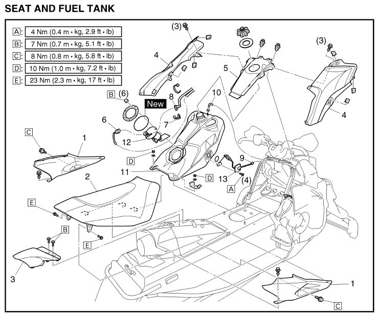

http://www.ty4stroke.com/attachments/seat-and-fuel-tank-jpg.90488/
Looks to me like its the plug at #9

Dad came inside asking why I had no fuel....tore it down and on the right side behind the reverse lever there is a green plug with two wires. This is the level sensor plug as the other end goes into the side of the tank one of the prongs had some corrosion. Electrical cleaner and dielectric grease and its brand new again...I swear this time!
