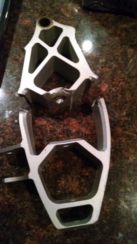

I was playing in a field with some other guys and came over a hill, landed, and grabbed a fallen tree that was under the snow. I broke the spindle in half and I think I tweaked the subframe. The sled is an 08 Nytro Rtx. It looks like it moved about 1/2 inch in the pictures. Can I fix it or am I better off buying a new subframe?

Snapped a spindle and that's all it moved!?!?!?! Wow!
IMO I'd use a prybar to bend it back and weld in a gusset kit and never worry about it again.

I wouldn't worry too much about that, most nytro's will look similar to that if you look around he used aled market.
Massrider33
That's interesting. I rode it eight miles back to the trailer with the spindle duct taped together. That was interesting. I will probably fix it and gusset it when I get my oilite bushings in because it will basically be all apart

Is that a 2008 frame or has it been replaced with a newer frame? Did it shear the ball joint bolt?
Massrider33
It is a 08 frame. It only bent the bolt on the lower A arm.

Massrider33
I'll have the frame out tomorrow and will see if it's buckled. What is the concern with it being buckled? Can it be fixed?

If it's buckled there is no good way to correct it and it's one of the main support tubes. Typically the 08 frame will also be out of square which is difficult to repair. I've ran across a couple 2008 frames that should have been replaced but the owners wanted to correct as much as possible and then weld in gussets so it didn't get any worse. If you can recenter the shock in the upper a-arm with a pry bar and the ski tips aren't staggered it should be good enough to reinforce and keep running.

Ok so if its buckled I'm probably better off getting a new frame than trying to get a already weak frame back to square?
SteelerJim
I would get a new frame. Put Grizz gussets in then install. You would have to total the sled to bend it then. I was able to get the subframe on my 11 pretty close but in hindsight I wish I had just put a new gusseted frame in. Then it would be perfect
