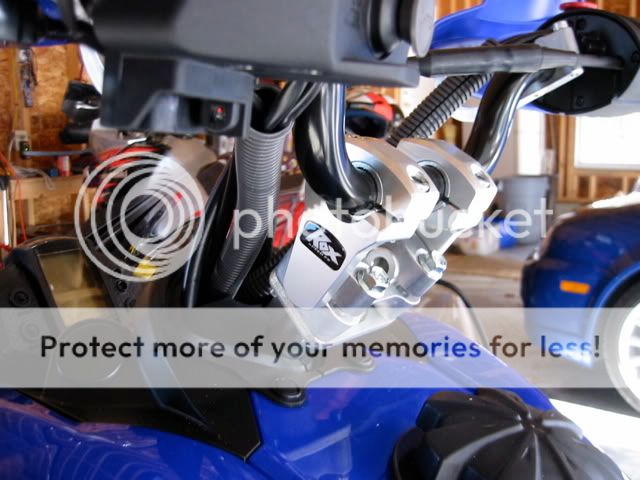

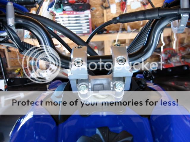

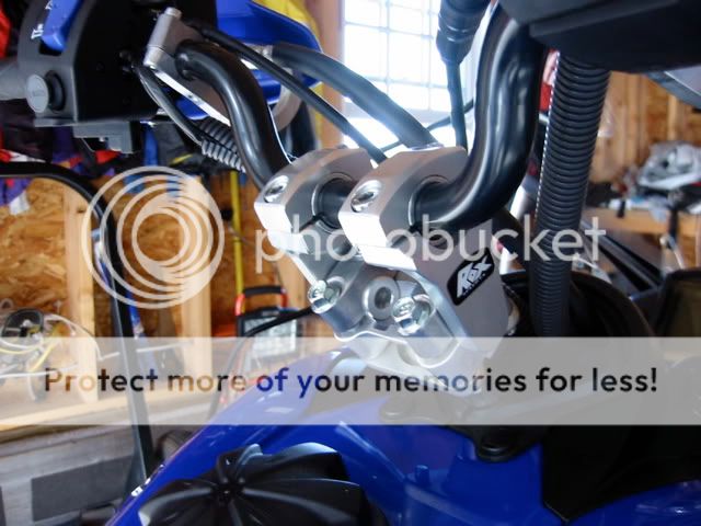

Nice Rumble
2" pivoting Rox Riser on my XTX and no cable issues.
