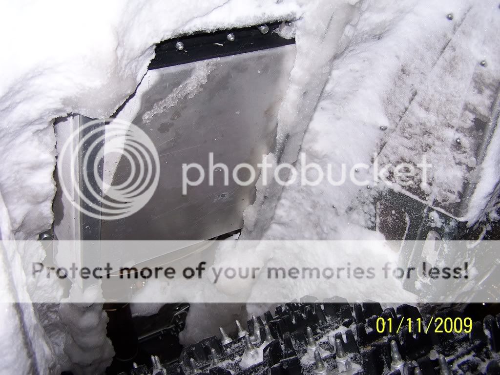

Snoxracer242
Just a couple of pictures of the one I made for mine, it seems to help quite a bit.
curryd
Snowxracer, What size is the plate? Is it installed to the protectors or the tunnel itself? There is hardly no snow build up at all. More details would be apprciated.
