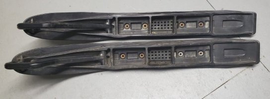

I am a newbie rider and got myself a 2011 Yamaha Venture GT I took it for a brief ride at the end of last season and it wouldn't turn properly. Say when I'm turning right it would kinda push forward as opposed to actually turning. After some research I know this sled needs to be set up for my weight etc. but I also want to eliminate the skis and carbides and put new ones on. Currently I think I have a basic Yamaha ski and when I google the model number nothing seems to come up except for the attached picture.

Thanks for the responses. Does anyone know exactly what ski that is in the picture I posted? Just want to make sure I get the correct installation instructions off of the snow tracker website.

It looks like the stock Yamaha ski also used on the Nytro’s.Thanks for the responses. Does anyone know exactly what ski that is in the picture I posted? Just want to make sure I get the correct installation instructions off of the snow tracker website.
- 7,696
standard saddle less rx1/venture/vector ski in picture.
