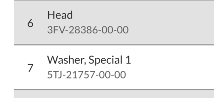

Does anyone have the Yamaha part number for the hood lock fastener bolt for the Nytro 2009, had a spare from a sidewinder who didn't work
