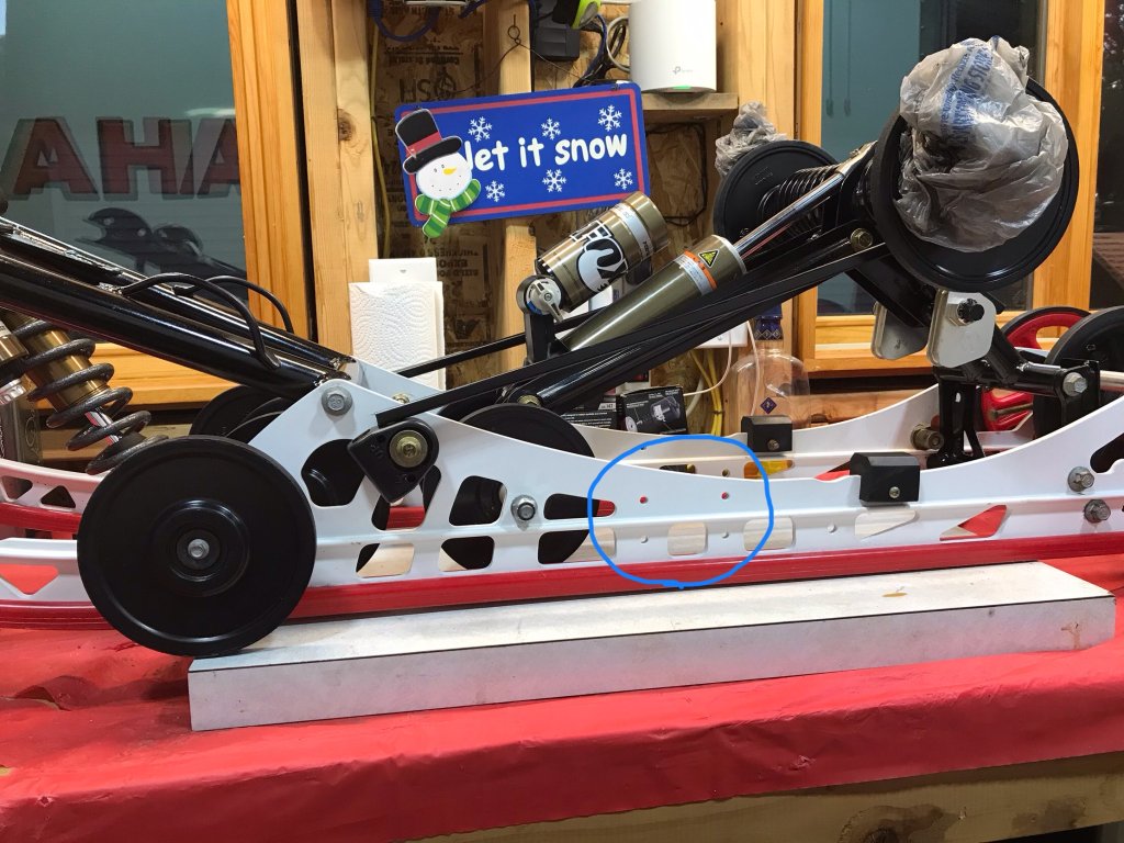

Hello,
I have the skid out and have gone through it to get ready for upcoming season, and I was thinking about adding an additional idler wheel to the outside of the rails. In the pic attached there are pre-drilled holes to accept the wheel mounts. Is it ok to add a wheel in these locations? It seems so to me, but I thought I would throw it out there and get consensus?
Steve
Steve

I don’t see a problem with it. As long as when it’s full collapsed it don’t hit anything your golden.

Some aftermarket options here:
I was looking at these for my SRBiper, but haven't pulled the trigger.
Hyfax – Slide Saver Wheel Kits | SchmidtBrosMotorsports.com
This marginal snow wheel kit saves the hyfax from being wore down at the arch of the rail where hyfax wear is greatest. You will spend less time and money replacing hyfax and achieve a higher top end speed.
www.schmidtbrosmotorsports.com

Those little wheels are junk. Because they are so small, bearing wear out twice as fast, they ice up, stop turning, and last about 500 miles.Some aftermarket options here:

I had purchased 4 additional wheel mounts and hardware just like the original and added heavier duty wheels to my 17.
No issues at all.
Hyfax didn't wear either after adding them.
No issues at all.

Yup, RPM is very high on those little wheels at 100+ MPH. At 100 MPH, track is turning 12 times per second. Haven't figured it out but I can only imagine what the RPM is on those little wheels! That said, the Procross rails that I've seen have a problem with hyfax wear on the curve coming down from the drive axles, and of course further back between front idlers and rear wheels.

What wheels did you go with, I'm looking to replace mine. Inner and exterior wheels...I had purchased 4 additional wheel mounts and hardware just like the original and added heavier duty wheels to my 17.
No issues at all.
1nc 2000
Lifetime Member Tim
- Feb 26, 2010
- 3,048
- Marquette, MI
- Yamaha FX Nytro RTX SE
Barn of parts heavy duty idler wheels for sidewinder.What wheels did you go with, I'm looking to replace mine. Inner and exterior wheels...

I replaced my 4 bogey wheels with the larger 147mm BOP wheels in my Viper this year. We'll see how they performBarn of parts heavy duty idler wheels for sidewinder.

Yep I have 8 on mine, kinda wish u had 2 infront of the rear axle also. Just get 2 mounts and bolts and 2 more factory wheels. Or replace all with j&t. I would suggest not going oversize on sidewinder as wheel is already large compared to rail with slides. They don’t need to wear much to just be 100% on the wheels as it is. Ask me how I know lol. As you can see my dad modeling a level for me. Sliders aren’t even at west line yet an that would destroy wheel mounts and bolts. Broke several per ride from half worn to this point.
