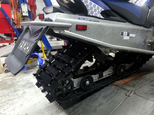

I did the 136" straight rail and love it. I do wish I had done the Star skid relocate at the same time but didn't want to spend more $. I went with the Ripsaw 2 and I LOVE it! Way better cornering. Don't cheap out like I did! Even if you don't do a rail extension, the skid relocate looks like a great idea. Good luck!
Tyloooor
At the start of the season I did the star 128 kit with ripsaw 2 and love it.....off trail is much improved. I can stop in the deep snow and take off no problem. The sled is way better over the stutter bumps. I will be changing the front spring in my skid like Robert from Start recommend this summer. I'm also thinking about adding a viper snow flap
RIGIDONE
I run a 129" 1.6 ice cobra.. It digs into the trail with no issues..It fawking rocks off trail. 1565mi on it this season, no issues with durability, top speed was increased with the better angle at the drivers. Moving on pavement is now possible too..lol
RIGIDONE
Yama 1000
I stretched mine to a 136" with the backcountry 1.75 last summer and would never go back to anything else. This set up is great for the trails and off trail in the deep stuff. I ride 90% of the time on groomed trails.

I installed a 128" Ripsaw II track, Tracks USA rail extension, and 153 Woodys studs last summer. I rode this past winter with this new set up and felt it was a significant improvement. I am glad that I went with the 128" track. No doubt, this is an expensive upgrade and should be done when a new track is needed. I decided "not" to go with the skid relocate. Over all sled stability has been improved.
I have pretty much completed all upgrades that I intend to add. I most likely will ride this sled for at least 5 more years.
