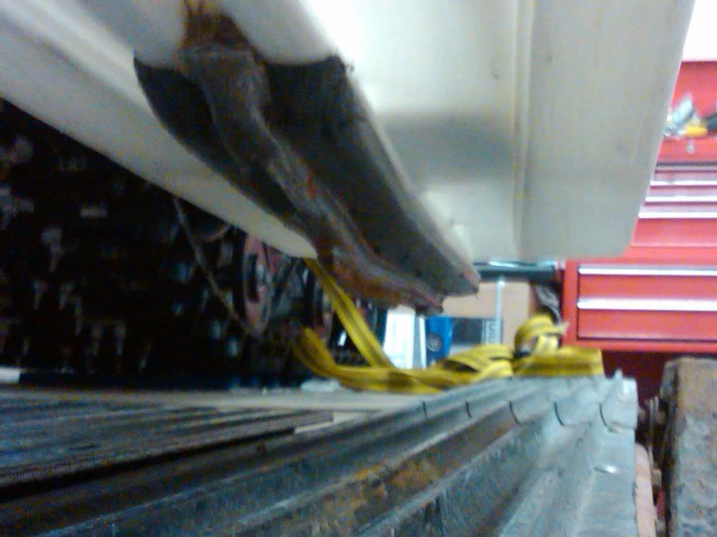

I have had 4 shaper bars (2 sets) end up looking like the picture below. No more they are junk IMO. I put on some beefy duals now from snow studs they will take a beating!

Over 1500 miles on mine and I picked them up used still in great shape.
