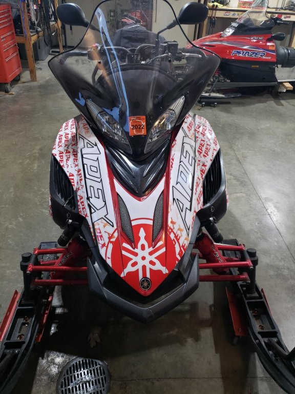

I used a heat gun to help with the curves and I also used Windex instead of soap and water
