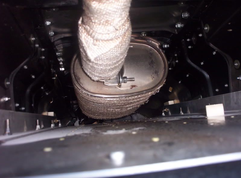

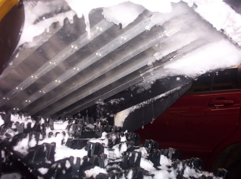

Here's the result of running the exhaust system straight back out the rear bulkhead and isolating it with an aluminum sheet from the front of the muffler to the rear bulkhead. No ice buildup.

That's excellent and exactly what I was hoping for. Everyone will want that now; you should patent your design! Any problems with heat build-up with the muffler enclosed? I have parts bought for the tailpipe extension but was unsure about enclosing the muffler. BTW, would you mind giving a brief description of how you did the work and any tips? Difficulties? What gauge aluminum used? etc. That would be great, thanks.Bugbear said:Here's the result of running the exhaust system straight back out the rear bulkhead and isolating it with an aluminum sheet from the front of the muffler to the rear bulkhead. No ice buildup.

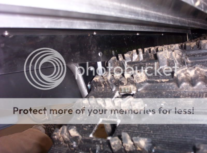

Well, after shutdown, the deck behind the seat gets so hot from residual heat from the exhaust that I can't hold my hand there for long. Used a piece of plywood atop the passenger seat mounts for some space.
Wrapped the exhaust with header tape.
Mounted an inch and half X eighth inch aluminum angle to each side using two quarter inch bolts at each end and spaced off with 1 inch plastic spacers.
Welded up a fixture to secure the exhaust tubing at the rear bulkhead.
Riveted half inch angles to .063, 5052 alum. sheet for stiffness to prevent oil canning (stretching).
Glued 4 inch wide X eighth inch thick neoprene to straps.
Fastened every thing together using 3/16th inch aircraft maintenance style nutplates rivited onto the two basic structure angles and 10-32 stainless machine screws. Pop rivets ain't gonna cut it.

Apparently this mod has no heat issues. I just crawled up and forward on the top of the track and got a good look at the exhaust system and the structure from below. There was not a sign of over heating. The black powder coating on the steel structure above the muffler and exhaust tubing showed no signs of heat.
I'd speculate that the residual heat is there in the two up configuration but not noticeable 'cause its covered up and is not high enough to damage what's covering it.
Afte the ride on Saturday,(temp. averaged 3 deg. F.) some very wet slush fell out of the front part of the skid when I got it up on the trailer. That's never happened before. Got one bucket of melt water at thaw out in the garage. Previously I got three buckets.

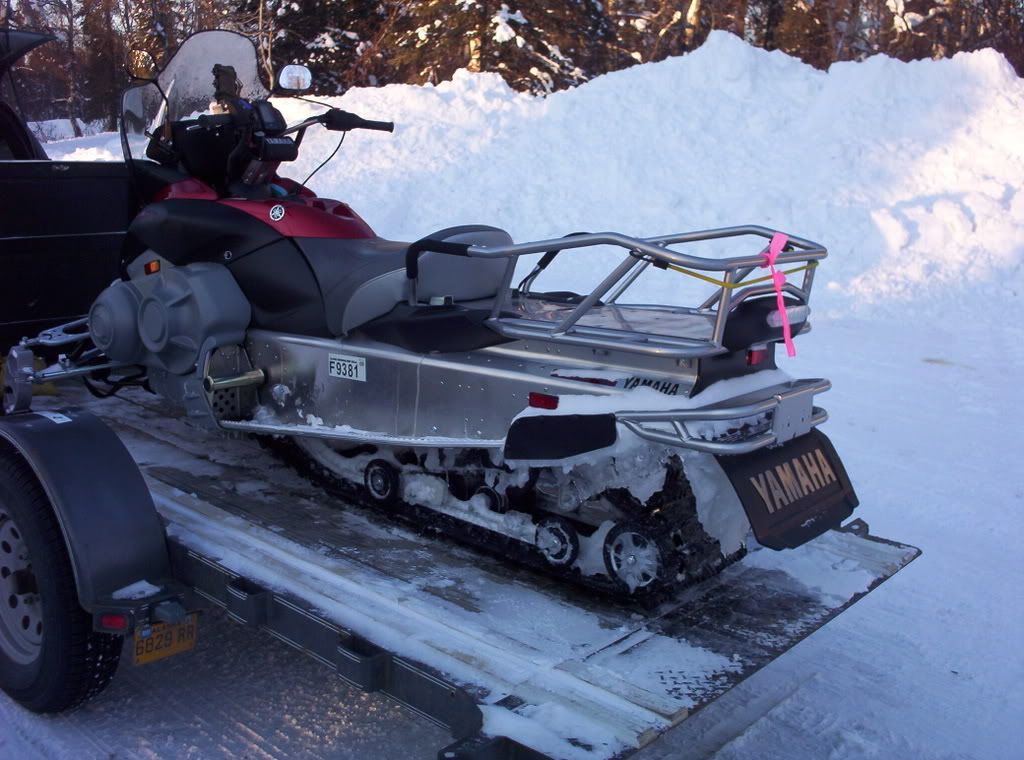

So, it seems like there is ice build-up on the outside of the tunnel now (on the running boards and around the rear grab bar)? Did you have that before (mine didn't ice up in those areas, just underneath and around the rubber snow deflector)? I'm wondering if that is occurring because of the sides being heated from the exhaust now and also the warm air exiting at the rear.

Yeah, iceing is different now. Glad you brought that up. Got a little oven there probably. We'll see. Here's a photo from two years ago.
The aluminum sheet is flat and ends just fwd of the muffler. No lip or debris barrier. Everything fwd of the muffler is open.

You can see that now there is icing to some extent on the exterior. That is a new development but it's no issue. Half of the one ride I've had so far was on a lake for probably 15 miles in a foot of power. Hit max rpm several times just to enjoy the torque. I wonder about the hurricane in the tunnel. There is evidence of melt water on top of the aluminum sheet and there was some slush which fell out. The edge sealing is pretty tight. Maybe too tight. Maybe some drainage provision would be in order. Wish now that I'd extended the exhaust out a little more.
